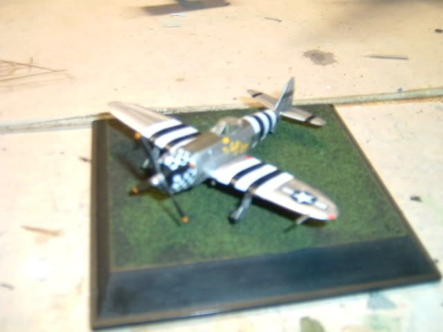

How about a really crappy picture?
1/144th Scale: (1 bar= 1/10th an in.) All 5 stripes = just under 1/6th an in.
PostPosted: Thu Nov 12, 2009 7:35 pm
Posts: 11332
If one stripe is 1/10th of an inch (.1"), then 5 of them would be 1/2" (.5"), right? 1/6th of an inch would be .16667".
So at full scale the stripes would be about 14" each? Wasn't there a Tech Order for application of these stripes?
