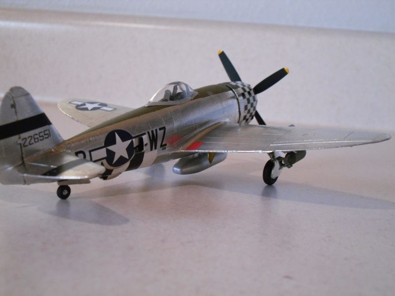

I tried a few different things and finally decided to give the BareMetal Foil a shot. The stuff is awesome! I was intimidated to try it but it's not that hard to work with at all. It took a few hours to apply, but I would surely get faster and do a better job after I got a couple more under my belt. I would recommend the foil to anybody!
This is the Tamiya 1/72 scale P-47D, which I was also impressed with after some of the stuff I've built lately.

I'm glad the foil method is working for you!
As you said, it gets easier to use the more time you spend with it. And for everyone else, make sure the foil is fresh--it loses some of its adhesion if it sits on the shelf for several years.
