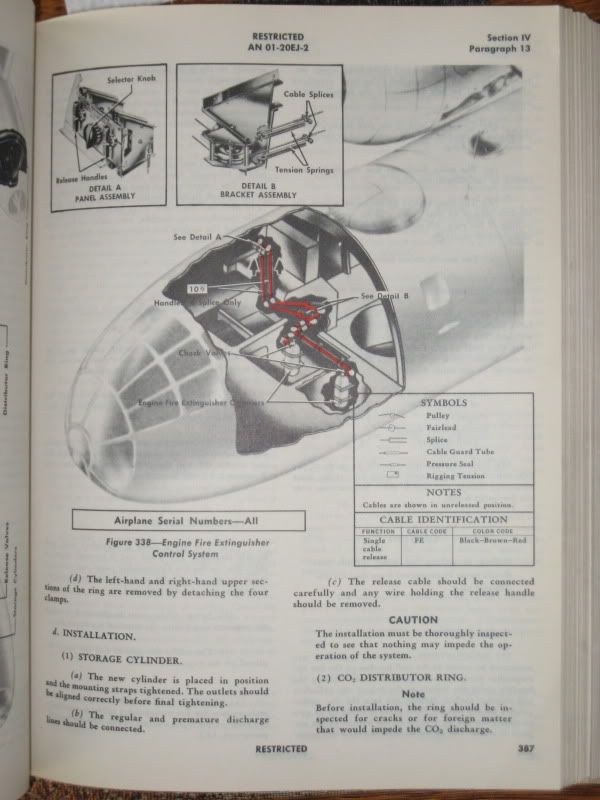

WIXerGreg is correct. They are the engine fire bottles. You all shamed me into digging out my now unneeded B-29 Maintenance Manual. Here are a couple of excerpts:
Scott
