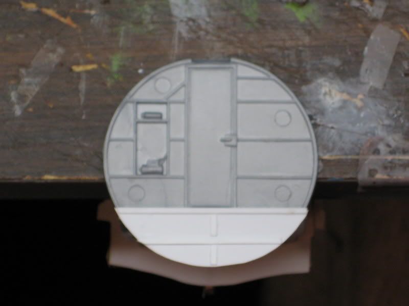

Things have slowed down with this project now that the lawns and garden need tending, but I did tinker with it a little on a couple of rainy evenings. Here is the radio room aft bulkhead partly filled in:
This will need a bunch more work (especially those nice ejector pin marks), but I'm not sure you'll ever see it through that litte entry door on the right side of the fuselage.

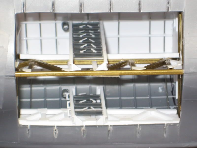

The connecting doublers on the keel truss are fitted and two more racks test fit in this picture. The racks still need lots of tweaking and detailing before they are ready for permanent installation:

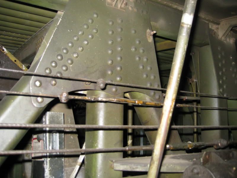

Well, the only time I really had to work on it was on the weekends, and now I've got my head buried in this during my free time:

PostPosted: Tue May 12, 2009 7:39 am
Account Suspended
Posts: 2713
Wow.., those flight control connections almost look R E A L !!!! :shock:
niiice job!!!!!!!!
:wink:
S.
PostPosted: Wed May 13, 2009 5:12 pm
THat is awesome.
PostPosted: Wed May 13, 2009 7:16 pm
Posts: 3442
That is the left wing aft spar truss on Chuckie and it is really, really clean for a sixty-five year old Fort. Folks have taken really good care of her over the years, and it shows.
