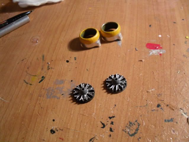

I started by foiling the whole cowls and then masking off the back with frisket film, then painted the yellow. I cut thin strips of the film to mask off the checkered area and spray the black but had problems getting the film to stick to the yellow paint. I got a few strips on one cowl but got frustrated with it and set them aside for a while. To try to get the film to stick better I did hit the yellow with a thin coat of Dull Cote, let it sit for a few minutes and pulled the mask to let the edge lay down. I haven't gone back to it since laying the clear down, but I expect the mask to stick much better to that than the paint.

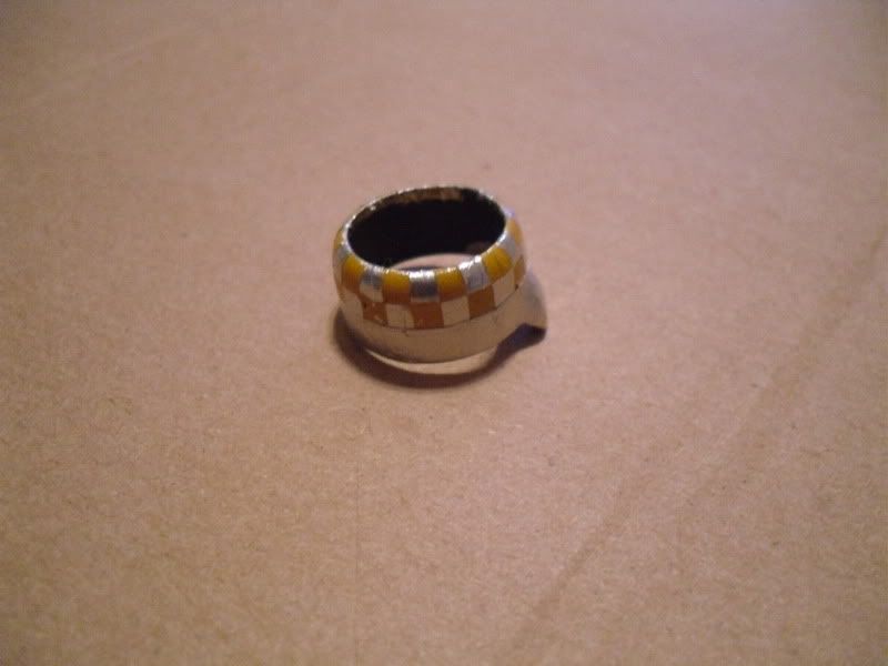

Using Foil to mask the checkers was one option I had considered but I didn't trust myself to cut all the squares straight. Last night I tried a couple different things with the frisket film again and had sort of the same problems. I abandoned that and layed one of the cowls out with Foil. I painted it last night and I'll peel it off when I get home, I'll have pictures up later if it wasn't a total failure!

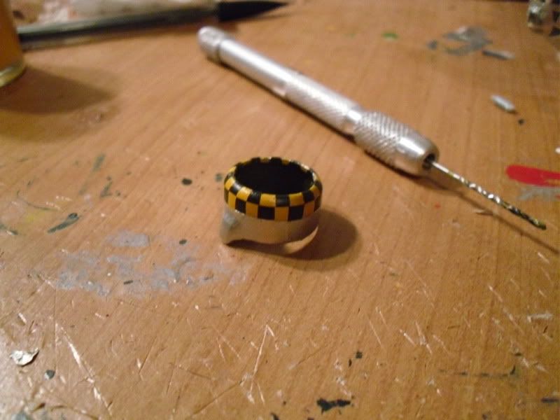

Success!
Starting from the beginning...

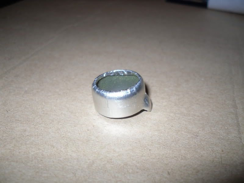

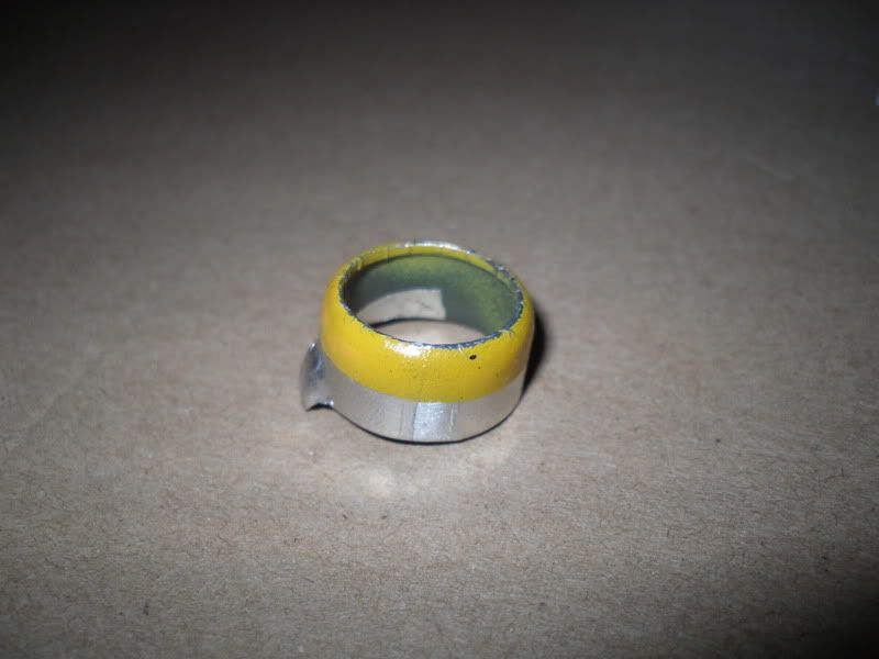

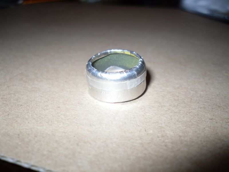

I foiled the entire cowls, masked off the back and painted the yellow fronts. The yellow also got a coat of Dull Cote along the way.

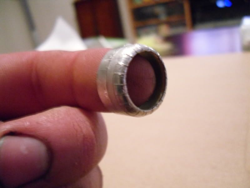

Then I foiled over the yellow, overlapping back past where the yellow stopped.

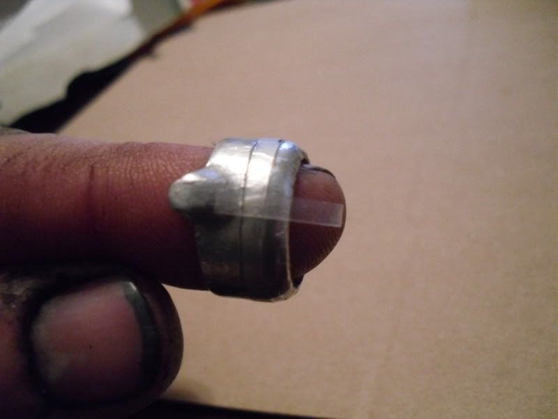

The yellow area from front to back was 6mm, so I cut 3mm strips of frisket film. I put it around the cowl, starting at the separation line from yellow to bare metal. Then with a hobby knife I made a cut on each side of the film, cutting through the foil. On the front edge this is the line between the front and back row of squares, in the back of the film it's the separation between the checkers and bare metal.
Then I used a piece of the 3mm film to lay out the checkers on the front half. I layed it on the cowl squarely, made a cut through the Foil on each side, lifted the film and made my way around the whole cowl.
After cutting the front half.
Then I lifted the strip of frisket film off the rear and cut the back row of checkers free hand.
I masked off the bare metal back side again and shot the black, then obviously peeled off the remaining foil to reveal the yellow sections. I'm happy with it!

Looks good! You've inspired me to give it a whirl on my cowls.

Wow.., I am very impressed with the end result!
Scott.., I think we have a winner. (in regards on how to do the checkerboard pattern!

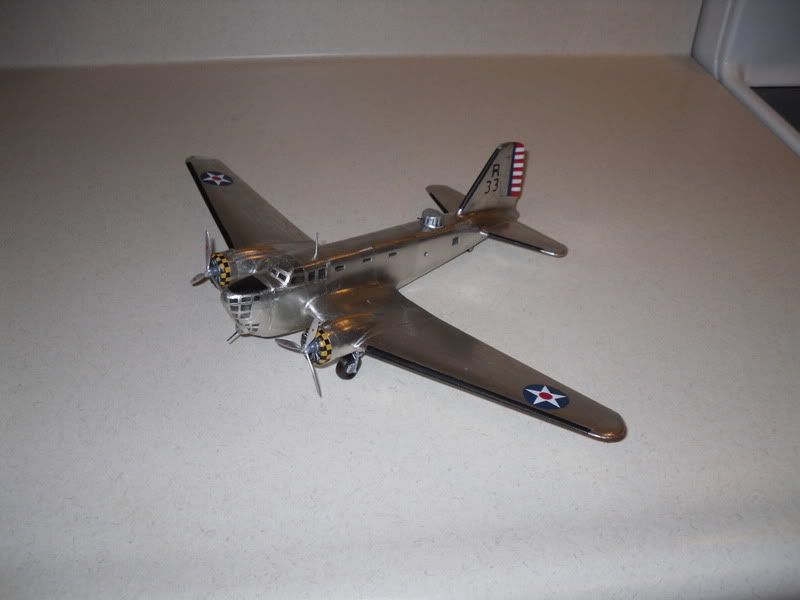

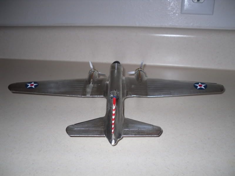

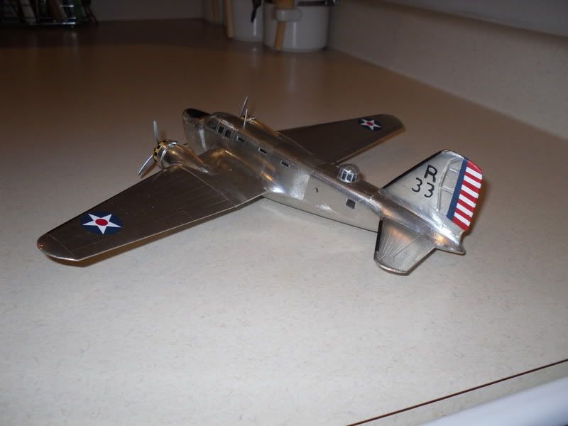

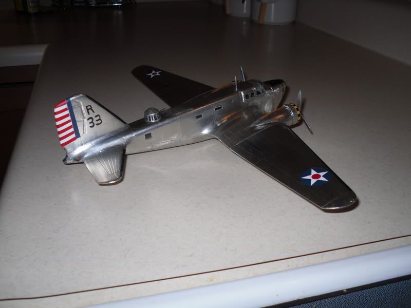

I finally finished the thing this weekend.

PostPosted: Mon May 23, 2011 2:37 pm
Great job! Looks superb- :D :D
