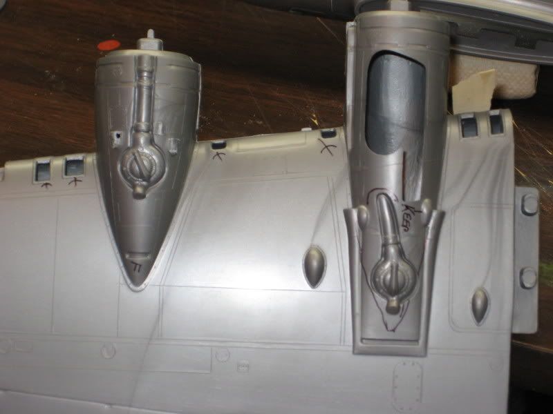

I did a little on the project this weekend, so here's a short update. I got the nose windows sealed up and the new windows located and cut in the left side of the fuselage. The Koster kit actually has the filler piece for the cheek window on the clear sheet, but I elected to fill with .030 styrene since I had to do so with the others anyway. I also removed the astrodome fairing and filled in a few other unneeded holes in the front of the airplane:
Next I started on cleaning up/modifying the wings. First I filled the intercooler and oil cooler openings in the lower leading edge with resin as a plug:
Then I got rid of the unsightly turbochargers under the nacelles by grinding off the excess plastic and filling the low spots with more resin, then a nice coat of filler:
This is the final right-hand lower wing after modification. The #3 engine and cowling are mocked up in this photo but still need lots of work, along with the front of the nacelles. I haven't decided yet if I'm going to lower the flaps or not--most photos show them raised, but they wouldn't be hard to drop if I decide to. Heaven knows I am familiar with that part of the Fort after being buried in TRs left flap well for two days!
One wing to go :roll:
Scott
