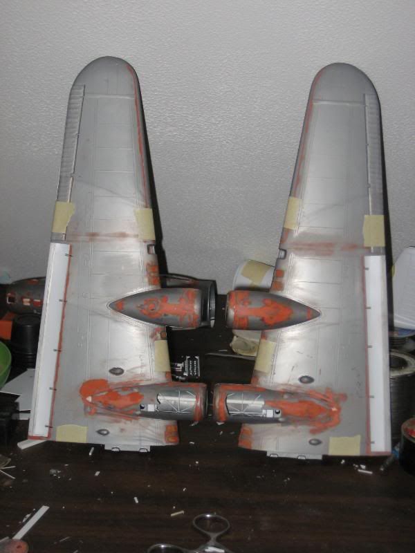

It's been a while since I worked on the YB project, but we got some ice/sleet/snow late last week and I finally made a bit of progress.
The first thing I attacked was the left flap well. I did the right one a long time ago and actually kept measurements, materials, and pictures so the second would not be a completely new project:
Next was the #2 and 3 nacelle interiors. The 299 and YBs used a totally different engine/nacelle support structure than all the later models. On the B and forward the nacelle is fully monocoque with the skin, stringers, and frames supporting the entire load. On the 299/YB there is a truss from the wing structure to the firewall that supports the engine mounts. Here are a couple of reference photos to show the truss. The bottom picture is the development of the Y1B-17A showing the early turbocharger mounting on top of the wing.
Here are both nacelles with the trusses constructed. All the plumbing and gizmology will be installed just before the wing halves are glued together. The long white half-tube at the top of the nacelles is the trough that housed the exhaust system on the real airplane.

We had to stay close to home this weekend and that gave me a chance to start on the intake/exhaust fairings that are a distinctive part of the Y1B-17 nacelle. On the real machine the intake for the carburetor is at the leading edge of the long fairing. Here is a really good photo from the Amarillo Mechanic School showing the intake duct and part of the exhaust system with the fairing removed:
The air that didn't go into the carb intake was ducted aft and appears to have acted as an augmenter, or at least as cooling air, for the exhaust. The collector ring exhaust pipe came up the right side of the nacelle, was routed into the long duct, and dumped at the end of the nacelle fairing. These two photos show the first fairing on #2 nacelle. I made the duct by splitting an aluminum tube lengthwise and shaping it as needed. To complete the installation I still need to build the intake duct and the collector ring exhaust pipe:

Another nacelle update. I had a little free time again this evening to devote to the exhaust system so I built the fairing for #1.
One of the little details on the YBs was the exhaust stack that runs at an angle from the engine collector ring up into the exhaust fairing. You can see the #1 exhaust pipe is installed in this photo and the trough for the #2 installation is marked with black ink. The outboard engines used a different routing than the inboards for some reason, and all four angled exhaust stacks are on the right side of the engines. The inboard ring cowls are cut back to allow room for the exhaust while the outboards are not.
And here's a close-up of #1 that shows the exhaust pipe more clearly, with a photo of a "real" #1 nacelle below the model.

Just good ol' aluminum tubing split lengthwise and gently bent at the aft end to fit the nacelle. The exhaust stacks are the same stuff. I thought about using brass tubing but the aluminum is easier to cut and shape. I'll probably use brass rectangular tubing for the carb intakes, providing I find the correct size tubing. Otherwise I'll use plastic sheet.
