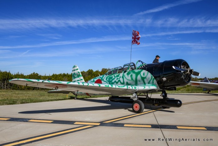

1945 built AT-6D (N3242G) that operates in the CAF's Tora! Tora! Tora! airshow team.

PostPosted: Tue Nov 29, 2022 1:29 am
Posts: 4528
Nice. I saw her recently.
