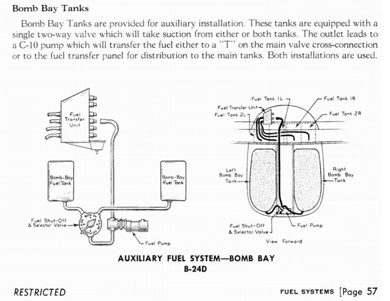

This is from the 1942 B-24D Flight Manual.
It doesn't have much detail, but it does at least show the general cross-section and size of the tanks.
PostPosted: Sun Oct 03, 2010 7:28 pm
Posts: 3442
That's the diagram I was thinking of! If memory serves there is also a more detailed series in the maintenance manual set.

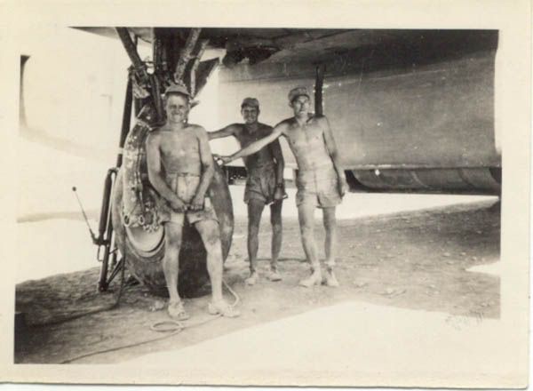

Wouldn't ya know it..
Will blundering around aimlessly on the net, I found a Romanian forum with a 100-something page thread on Operation Tidal Wave. Among the hundreds of useful pics was this one..
This is one of the Tidal Wave aircraft, just after the bombay tanks were installed. This gives me a pretty good idea of the configuration..any ideas as to color? I'm thinking dark gray/black, with metal straps.
