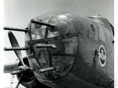

Here is a photo of a field mod where they put 6 50's through the glass nose. You can see where the K-2A socket was mounted originally in the nose and the left side and has since been blanked off.
The K-2 and K-2A were cast and the K-3 was stamped. The K-4 was similar but for the ANM2 50 cal gun.
