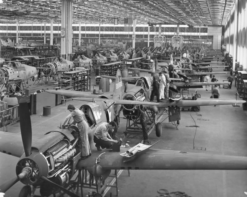

There have been published photos of Razorbacks on the assembly line that clearly show the exterior color continued under that section behind the cockpit. Just wish I could find them so I could post them here!

It would appear the folks at Curtiss OD'ed the area first and then installed the glass (Or am I misunderstanding the question?).
You pegged it. Curtiss seems to have painted just that area first where as Republic painted the whole fuselage and then installed the canopy.

Logic would indicate that the area behind the cockpit would be OD on camoed airplanes so as to not detract from camouflage. On a NMF there would be no need to paint it, though a few planes during that transition might have had OD, or chromate there.
