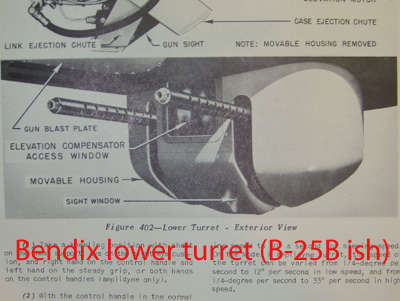

I think there were a number of late production B-17Fs that had chin turrets...it was a short-lived but a bit confusing transition from B-17F to B-17G.
Also, of particular interest to me is that a bunch of the surplus and unwanted B-25 Bendix lower turrets were supposedly shipped to England to be installed on B-17Fs as a stop gap measure. They retained the same aiming system as used in the B-25 and was just as unsuccessful in practice. Those modified B-17s (if any) evidently had the turrets quickly removed and the groups just waited for the new B-17Gs. (Source: AAF Study Development of Aircraft Gun Turrets in the AAF, 1917-1944).
I've been looking for a photo of one of those Bendix B-25 turrets on a B-17F but have come up empty so far. The B-25 turret had a different cover than that later used on the B-17G, and most likely retained the aiming periscope sight window on the turret.
