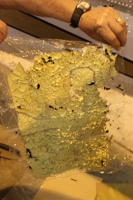

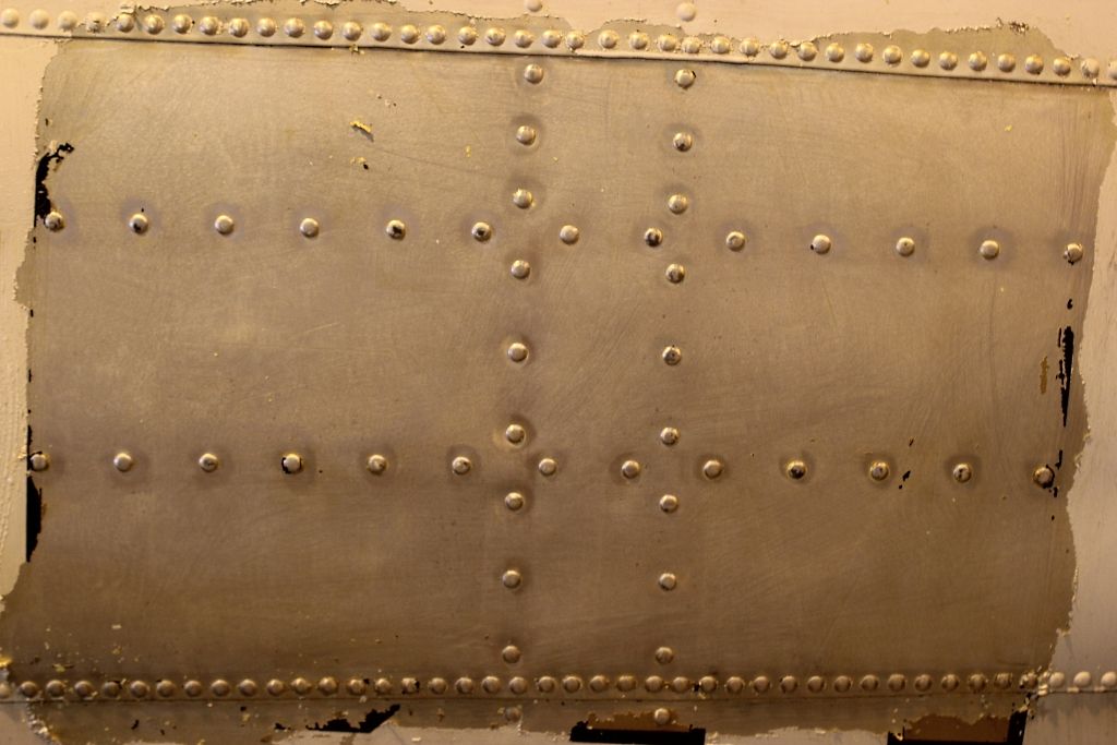

The next morning, we all gathered to removed the plastic and then remove the paint. To our shock, as we pulled the saran off, the paint clung right to the saran wrap! It left a near perfectly clean surface. We just did a light scrub over the few rivets that needed it with a stainless steel brush and the remaining paint came off without having to apply anything else.

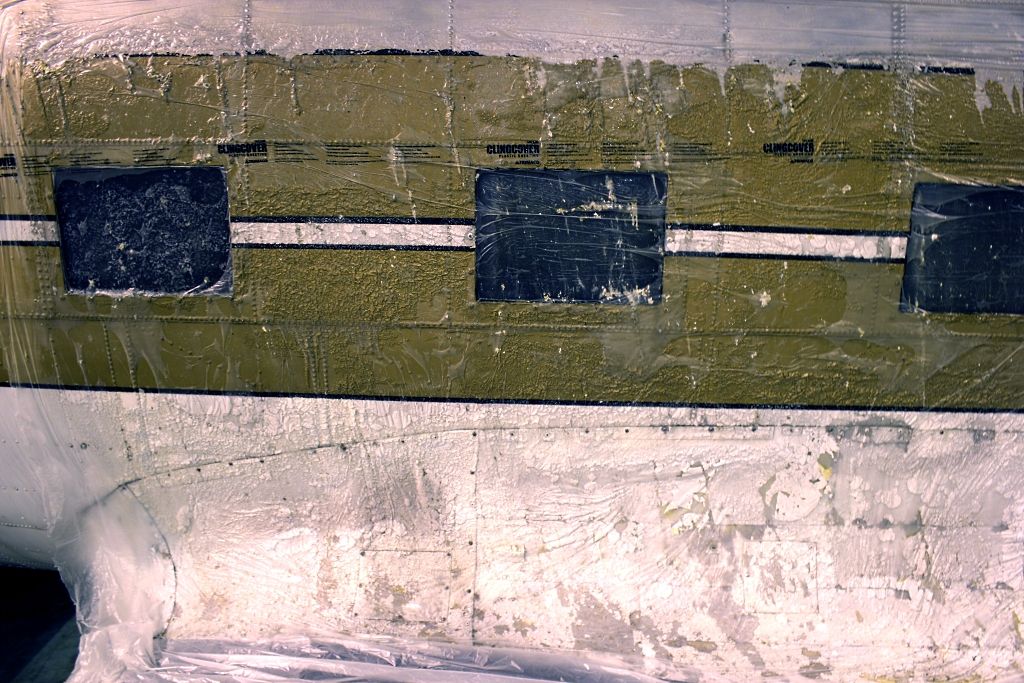

Today we received our 55 gallon drum of the stuff. We also purchased an airless sprayer at Home Depot to use to apply the stripper, which is working perfectly. I got the Graco X5 sprayer, which I plan on using should we have to paint the plane ourselves.
I have already applied stripper to two large sections on the fuselage and wing and will remove the sheeting tomorrow as a larger test with the sprayer. I could probably have the plane done in about 2 days if I did not have other people working on the plane as well, getting in the way.
The biggest advantage of this stuff is you spray it on and let it go. It takes more time to prep the sprayer and setting up the area than spraying itself. After your done spraying it on, you are free to do work on other things, which is a big plus in my book.

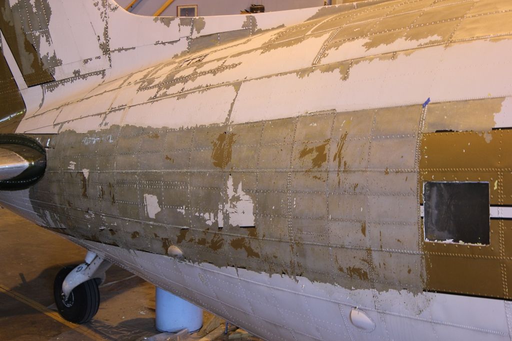

First small test patch after removal
The sheet and paint

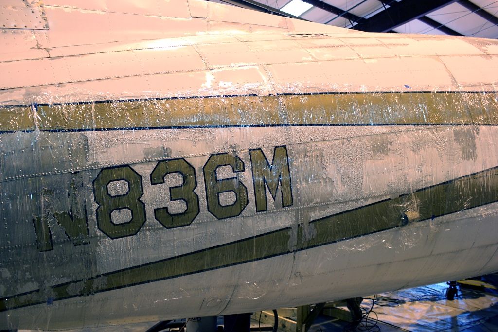

The larger patch as the stripper was still on after about 3 hours

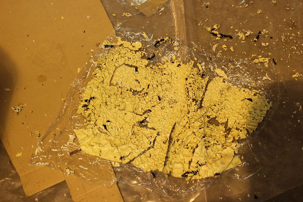

After
And Todays test patch using teh sprayer. This was after only about 30 minutes.
