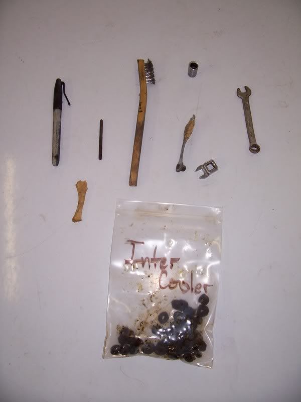

Another update.
Bonus parts! The bag of dog food came out of the right intercooler. This was just a little sample. Obviously a mouse found himself a nice warm place to make a nest. Maybe a little to warm! The brush came out of the right main fuel tank. Not sure where the bone came from?! We also pulled lbs of hardware from various nooks and crannies.

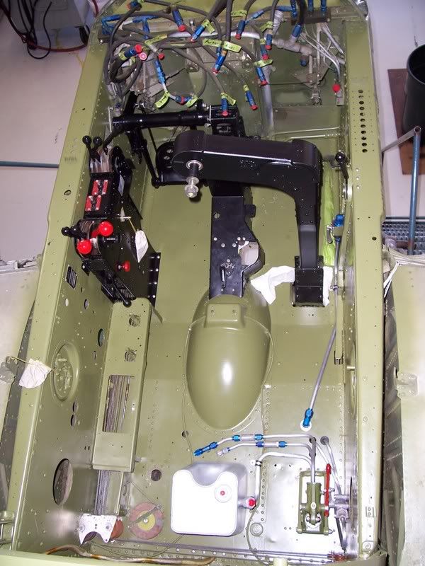

Test unit for setting up the coolant temp. control valves according the book. Worked great!
Cockpit is shaping up! No more electrical tape on the throttle knobs and hand painted placards. The cockpit will be detailed, with the rest of the airplane made safe/correct and not necessarily perfectly stock. We have removed the non-functioning Tallichet electric backup hydraulic system and went back to the stock system.
Control sytems are done after replacing all bearings and pulleys in flight control sytem. About 90% of the pulleys and bearings where frozen, fortunately only a couple control cables had to be replaced. Hydraulics are 90% percent finished after overhauling all components. Almost everything leaked and almost all O-rings where either original and broken into several pieces or in very poor condition (square). All components have been bench tested by the book before reinstalling.
Working on wiring right now, all Tallichet wiring has been removed and we are going back to stock system and wiring. What a mess! :?

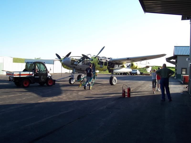

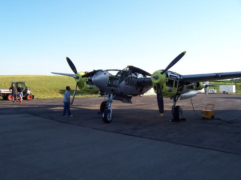

Another update
Sat Jun 30, 2007 8:25 am
Think we'll make it? First start Friday June 29 7:30PM
Sat Jun 30, 2007 10:44 am
Of course you'll make it. Failure is not an option.
